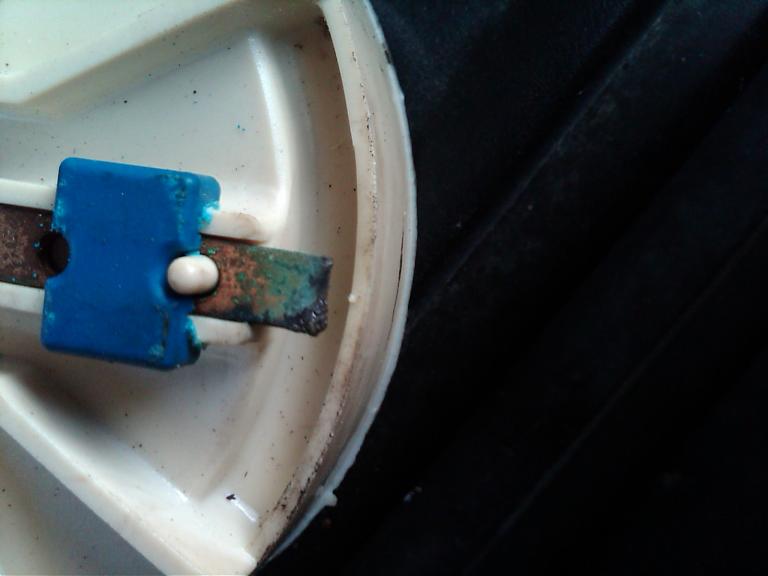

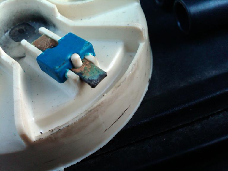

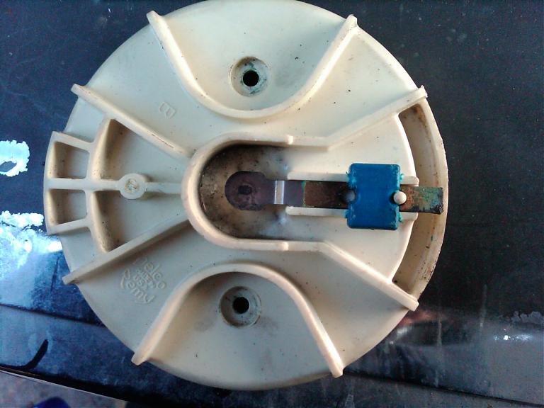

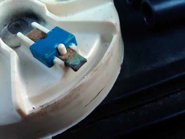

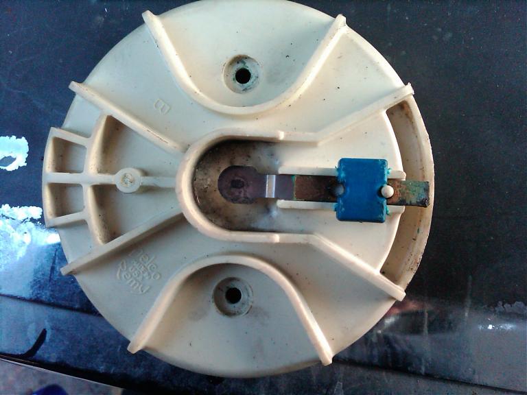

                              Threw a birthday party for my brother today, but I was able to get the cap and rotor off. Stupid torx screws...
                              This looks screwed - my Dad still thinks it won't start after replacing this. To me - this looks WAY toasted...
