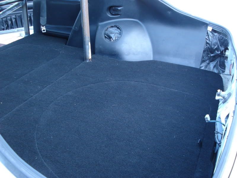

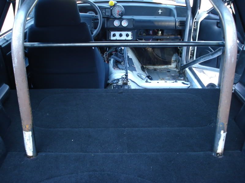

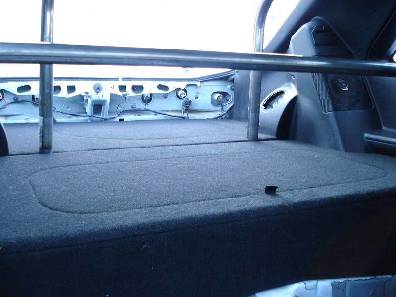

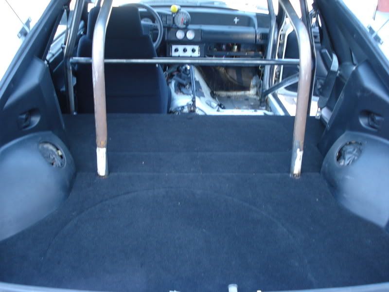

                        #26
                        made the rear seat delete work heres some more pics
                          #27
                          Looks good.

                            #28
                            That looks really good

                              #29
                              The hatch looks slick! my cage is going in over winter too, i'll get some pics up, in the process of getting materials together now to DA the car first tho, just wanna make sure the paint isnt holding it together before i weld in a cage

                                #30
                                That definitley is nice job, The only thing that won't certify(if you plan on it) is your main hoop mounts that are semi boxed on the floor. The reason I know is that I got shot down caging a car and doing the exact same thing. I know they say you need a 6x6 but NHRA wants it formed to the floor. I hope you have better luck than I did.
