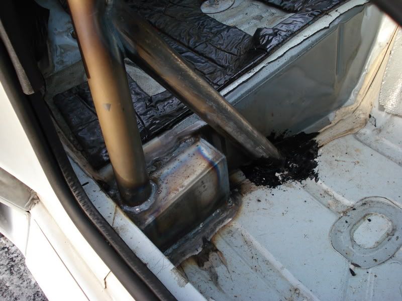

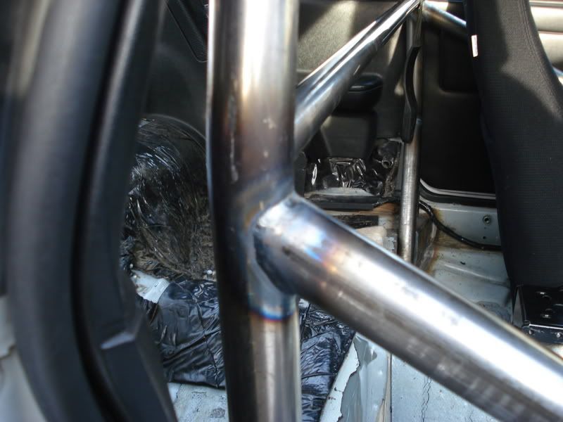

Some pics of Cage install
  • 91GTstroked
    • Jan 2006
    • 1893
    Its going to the body shop today for the paint, Probably keep it black to match interior.

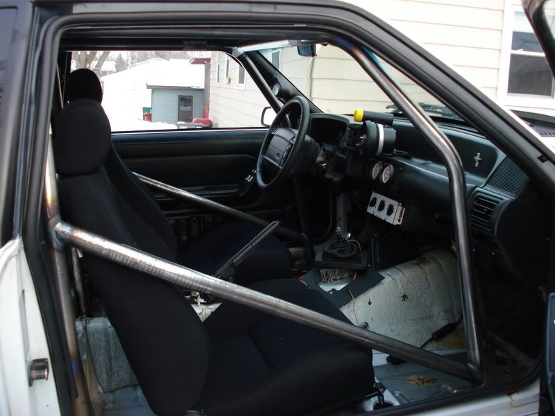

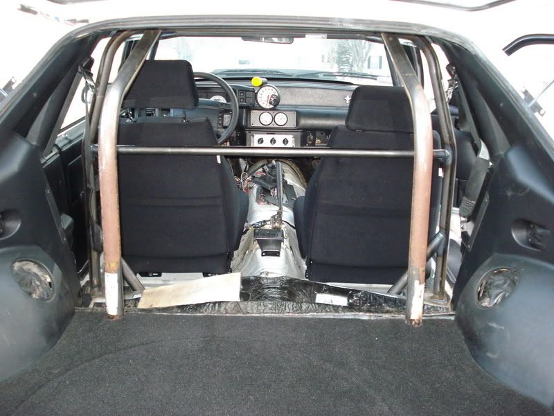

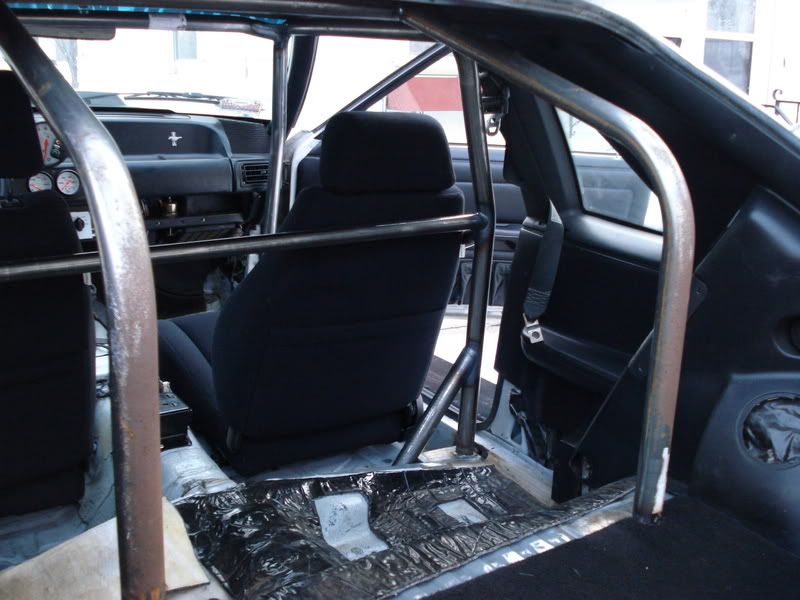

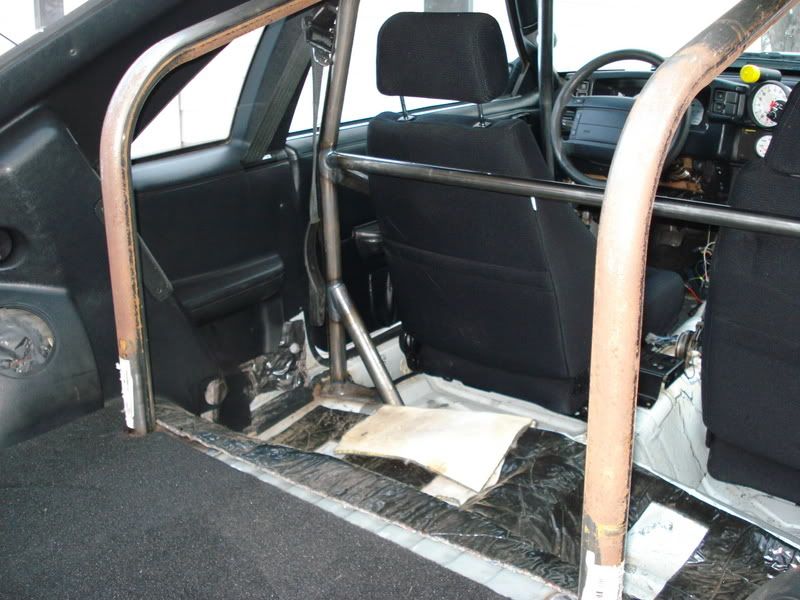

    ummm , ARE THOSe REAR BARS GONNA FLY??
    WWW.RACECARREVOLUTION.COM
    WWW.TRANSPORT-GRAPHICS.COM
      That looks really good, but damn your front post and door post are short, any reason you didnt extend forword to the kick panels and go down thru the front speakers??
      And your rear bars are almost 90deg. :cunfused:

        umm yes why would they not? This kit is made to go up over the rear seats if they were still intact.

          Originally posted by LESNOVR View Post
          That looks really good, but damn your front post and door post are short, any reason you didnt extend forword to the kick panels and go down thru the fron speakers??
          I didnt want to cut up the dash, I wanted to keep it somewhat stock without hacking up more stuff than needed, plus this will see some street use
            I understand that , and it can be done nicely witjout hacking up the dash, I only asked becasue of the street use, that thing must be a bitch to get in and out of, I know it would be for me and my big ass! Looks sweet though!

              It looks nice, if it were mine though it would go down through the dash
                well I'm not 100% sure, how the dash would be taken out lets say your heater core went bad, how you getting the dash out? Probably more hacking stuff up. You see by doing this it simplifies more stuff for me in the future.

                        Wow, that is fucking sweet. I guess you asked this, but how would your dash come out now? Is it even possible?
                          Heater core?? You drive it in the winter??
                          This is where you have to decide , is it a street car or a race car , and good luck getting your dash out now anyways. It is a sweet install never the less!
                            LOL, thats true, I like I guess thats what matters, my wife wouldnt ride in it much, now she really wont This is a minimal street car maybe once a week
