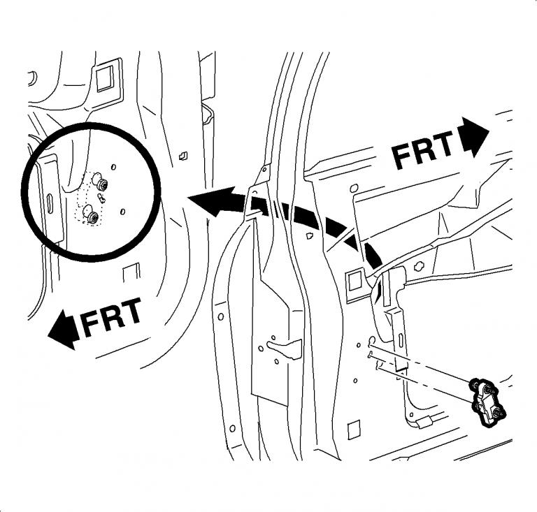

I'm looking for the location of the right side impact sensor on a 2001 Saturn SL1
Does anyone have all data
Maybe someone replaced the door and there is no sensor or wiring in it. Happens on re-builder's all the time. I would presume you are looking for it because you have a passenger side impact sensor code, correct?
Originally posted by mnstangthere isn't one thing that makes tcs look stupid either, it's really just everything.Originally posted by 2 beerBy the way, I am not riled up. I simply hate you.
It would probably help if you told us if the car is a 2 door coupe or 4 door sedan. The picture I posted is for a 2 door. I would assume now that you have a 4 door sedan and most likely the sensor will be in the B-pillar between the doors then. GMs website is not very clear on the 4 door. They describe it as being in the b-pillar, but give directions for taking the door panel off to remove itOriginally posted by Mike R View PostI looked, it's not in the door. The only wires that run to the door are for the speaker. Anyone else have an idea where it should be?
