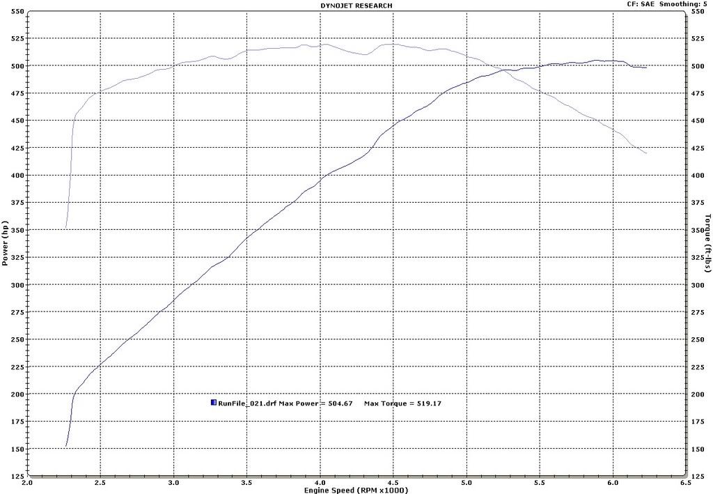

    Just finished up with this yesturday. A few years back we installed a Trilogy supercharger (a magnison M112, similar to the eaton but more efficient). We lated installed full length stainless works headers and full exhaust. Last year we tuned it up on E85, and it made 450rwtq 480rwhp.
    Well we just turned to boost up a bit, and this is how it turned out.
    Last year he went 11.9s, and is hoping for 11.5-11.6s this year.

        I hope that is not a stock bottom end.
        Either way nice 3's Casey. What all is need on the Maruader to convert to Korn?

              Yes it is 100% stock motor!! It lived all last year at 480rwhp with about 40 track passes on it. The owner knows that it could be a ticking time bomb, but im keeping the RPM low, and the spark is still pretty conservitive even with the E85 so I think we will see quite a few passes out of it this year too.

                      wow torque right when you put the pedal down... whats that like???
