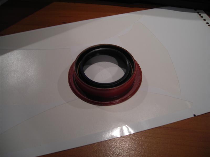

      How do I tell which seal I have?

        one seal has a flange on the outside, the other does not.
        Mine does not have a slinger on it, i would have to go out and glance but i think i have the seal without the flange. Cause the one with the flange will rub on the slinger if i remember right. I could make a call and find out for sure.

          My seal looks like this.

            What happened on my 302 build is between the double roller timing chain and the harmonic balancer there was no room for a slinger. Possibly the seal would have rubbed too, but you should assemble just the balancer and chain with the slinger to double check for interference there as well.
            Also, my engine was a '89 or '90 and I swear there was no slinger from the factory. It's possible I forgot about it and/or somehow lost it, but I don't think so. I had a spare slinger lying around from another engine and I tried to assemble that in there.
            I hope this is helpful for you.

              That's just it, I don't have the slinger and have no way of getting one unless I rumage in a junk yard.

                With that seal, i would say that it does not have a slinger, but i would double check to make sure
