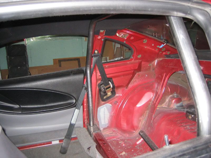

                              Got to gettin' on this project this afternoon. The main hoop is fitted pretty much now. I decided to mount it on the inverted U-beam on the floor, with 1/8" reinforcement plates under the main hoop pillars. I'm pretty satisfied with the fitment of the Competition Engineering kit. The width is perfect for mounting it on the U-beam. The top is pretty snug against the roof headliner. (it is standing up via friction fit in the pic.) Should it be that snug, or should I be able to see light all the way around it? I could easily shave off another 1/4" to 3/8" from each post.
                              Any ideas on paint colors? I am waffling between gloss black, and gloss red. Red would look pretty cool on the door bars that come down in the front half of the car, since it would contrast with the black/grey interior, but would blend in in the back half. Vice versa if I went with black. I suppose I could go with a gunmetal grey or something too....hmmm.
