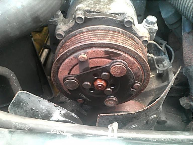

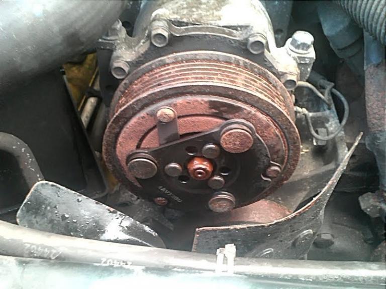

    So what is the best puller to use on this a/c clutch? Just a standard 3 jaw and get behind it? I want to replace the bearing in it. It's on a 2001 Jeep Cherokee...
    Thanks, LM

    Must use special puller. Rent one

      ^ Beat me to it. Most auto parts stores will have one. If you want to buy one they can be had for $100-200

        If not, go to Napa and ask for part BK 6601819. I believe the bypass pulley costs around $40.

              Do some research but Im not sure you can get parts for that clutch. Some of the Chrysler stuff is non serviceable and you have to get a compressor with a clutch.

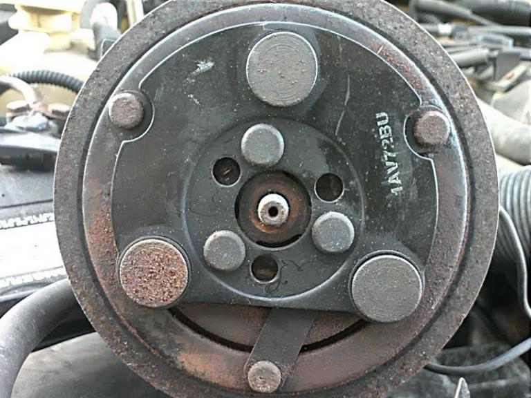

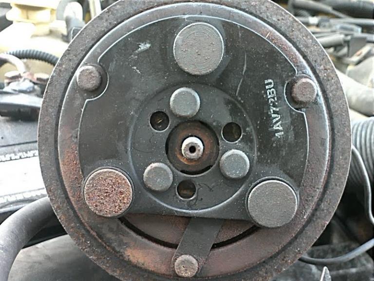

                Yes, the a/c works well...well it did until this clutch gave out. I have replaced the compressor once like 5 yrs and 100K miles ago due to damaging it trying to take the last clutch off that failed. This clutch has no threaded holes in the fron for a puller as shown in the picture I have attached. Any other ideas? I'd rather not break open the system again and just repair the clutch bearing which I do have a listed part number for. Here's a picture of the clutch..
