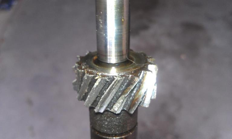

    Hi all I need a hand with a distributor install. Early this year I bought a 93 fox mustang 5.0l that had had the engine professionally rebuilt. About three weeks ago the car just stopped running I did all the normal diagnostics and figured it was either the stator or tfi module. I I replaced the TFI and it made no difference, so I decided that a rebuilt distributor would do the trick. I pulled out my haynes manual and followed the instructions on how to mark the position of the distributor. Then I pulled the old one out and discovered that the professional shop had put in a distributor with a cast gear ans the HO cam destroyed the gears. So I hand turned the engine to TDC and cannot get the new distributor to slip back in is there something I am missing? my dad thinks I somehow need to align the oil pump drive with the cam gear?? not sure any help is appreciated
    the picture is of the distributor I pulled not the rebuilt one

    some times its tricky to get the dist. To drop onto the oil pump rod I usually tap the key till ot drops in.

      that is what my gear looks like also
      I turn the rotor back 1 cylinder then it sides right in to the No.1 position
      if it is tight in the main bore put a little oil on the "O" ring on the dizzy base and see if it sides in a little easier

        Think of all that metal now floating thru the engine.
          I know right? Luckily for me it happened to my old motor and not the new one
            this.

              I would be sticking magnets from transmission services that I forgot to put back in, all over the bottom of the oil pan.

                or buy Summit magnetic drain plugs.. I did and they work great
                  yep hopefully the oil filter caught most of it, when I get it running I will let it warm up and then change the oil and filter, and then I will let it warm up again and change the oil and filter. The way I figure it has been driven for almost 40k miles with that distributor in it and it has been wearing the whole time. if I am wrong then it needs to be rebuilt,... well then it needs a rebuild,..
