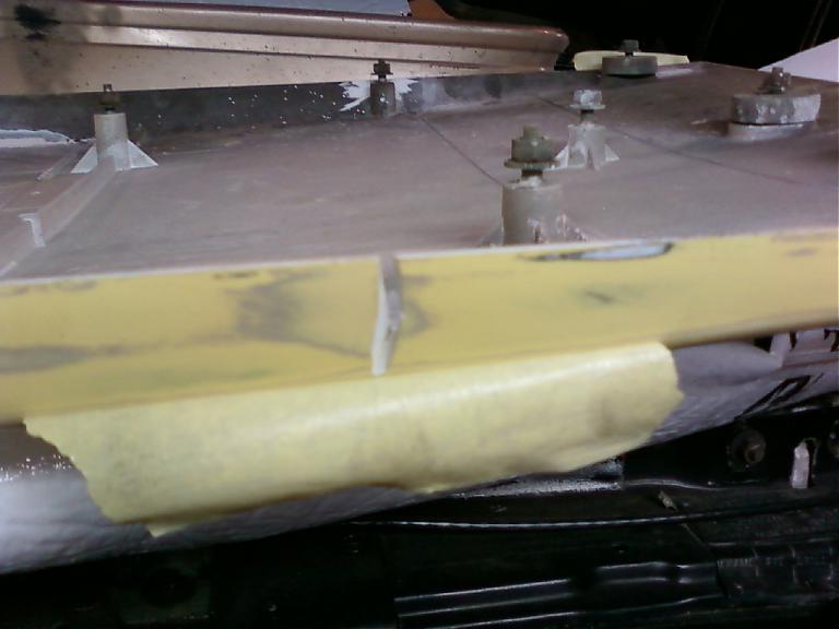

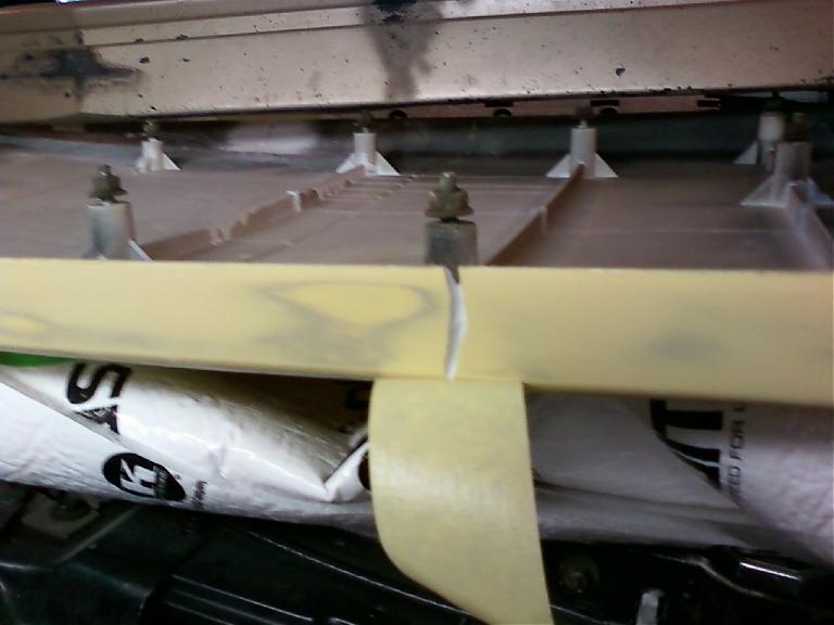

    What should I use to repair the cracks in the hood scoop. Fiberglass mat and resin or I have a plastic welder. I believe it's ABS plastic. I've already ground out the cracks so now I just want to make sure I use the right thing. I don't want it to crack again after it's painted.

    I've been doing some plastic repairs of late. ABS can be made into a paste with acetone. Drywall fiberglass tape can be used to back the affected area to reinforce it. Melting or using a different compound to repair it may make it more susceptible to re-cracking.

    My first gen crx has super brittle plastic parts so I've got some practice.
    I've then followed up the fill with a palm d/a with 320. Sands out just fine.

      melt window screen on to the back side then use abs plastic repair material on the top side. follow all the instructions to a T, anything else will fail again
