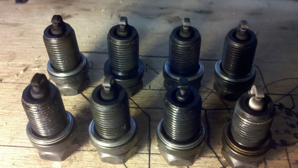

    I have been experiencing an intermittent miss on two cylinders and it was really messing with fine tuning. So I bought new plugs and wires to remove the possibility of both, the wires were old and ratty anyway. I had been using Autolight 3922s and I know they were way too could and were going to foul, so I fully expected it to happen so I bought a new set of hotter 3924s to replace them. But when I pulled them, I found this.
    #1 shows lean, #8 is dark, #2 and #4 are fouled and the rest show decent timing but are sooty.
    So it appears I have 2 cylinders fouling and possibly a bad injector, thoughts?
    they all look fouled to me there buddy.

        3924s, I have new ones.
          that thing runs like that?
          i would toss my motor in the garbage if my plugs ever looked like that.
          but back on topic
          car is way to rich
          car is burning oil like crazy
          and hole 8 somthing is broke

            With the 8 million curves that thing has seen in the last 2 weeks, I don't know how you could possibly get anything out of reading these plugs.

              car is way to rich

                check compression, if thats ok swap injectors around. ill PM you my cell number call me when you find the issue with number 8
                  so did you roll the spark plugs around in the dirt or is your motor that filthy?
                    Its not that dirty, probably just from handling them.

                        x3. Plug reading procedure is sure a hell of a lot more then just taking plugs out of an engine that has run under it's own power
                          is this thing running budderiggs old holley heads? because if so id say youre using some oil.
                            He had 2 bad oil rings, I know because we took it apart, ringed, and rebuilt it in two days.
                            I have a new set of rebuilt 30#rs that I am going to toss in with the new wires and plugs, should fix the problem.
