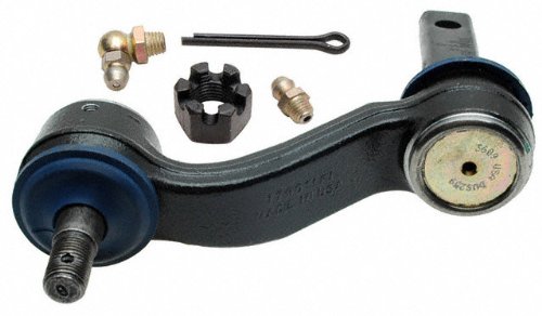

                Check. Moog even.
                • xjfish
                  siiiiiiick!
