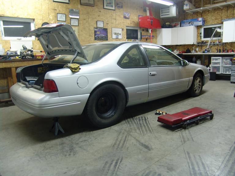

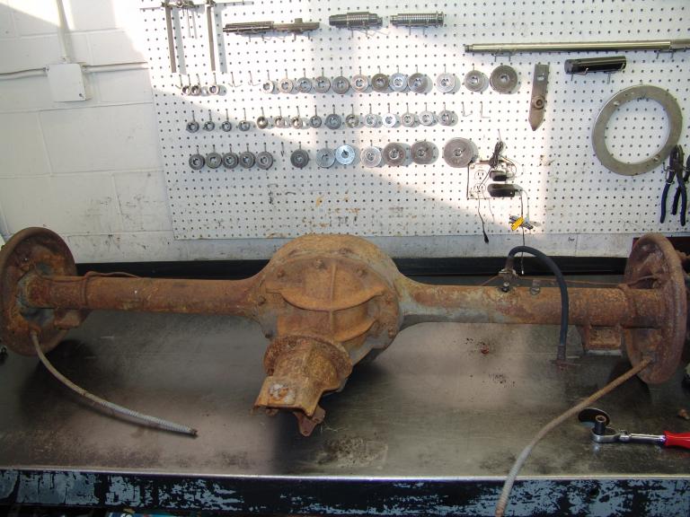

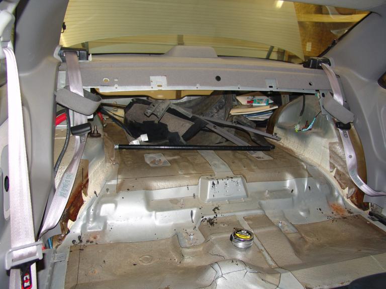

1997 car bought in 99. Had fun with it for a couple years... until I realized the limits of IRS. I have had multiple rear subframe combinations in the car. It was always IRS. Sure, it could get sideways through second gear and chirp tires going in third at 55. 4.56 gearing and Auburn pro worked well but without instant center to plant the tires, it's just a fucking waste of time. The last 4 years the car got 150 miles put on it. I was bored with it and finally decided to get serious with what I planned on 10 years ago. Alstons Chassis Works 4 link back half and a 9".

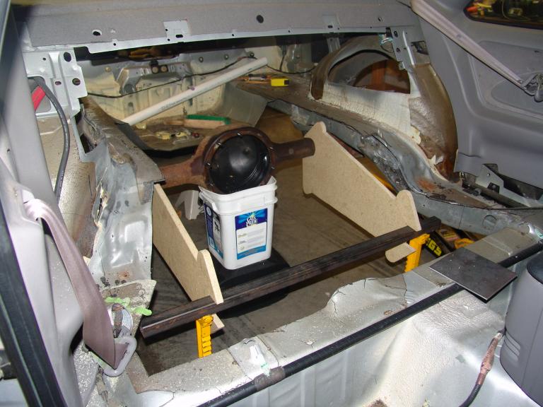

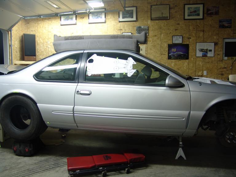

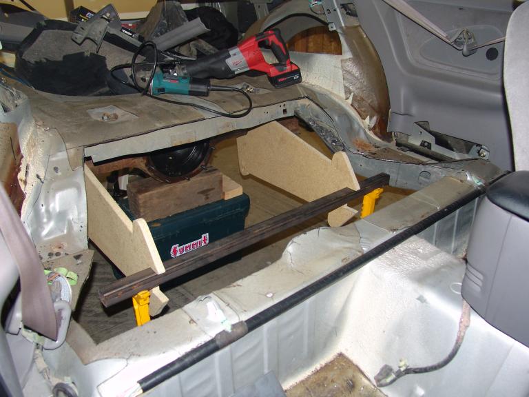

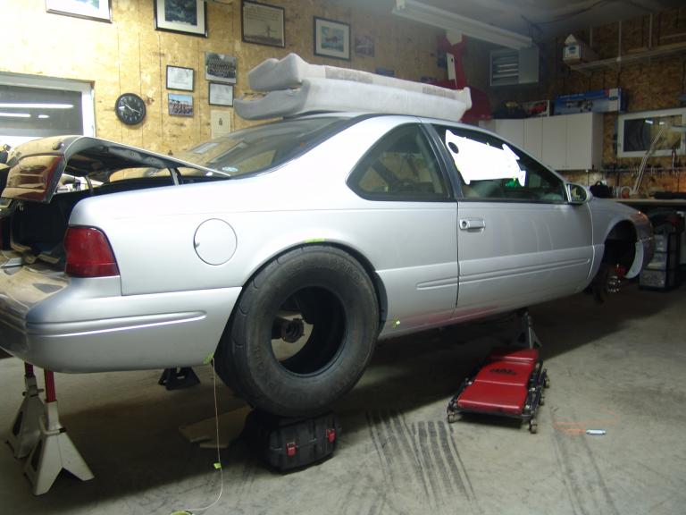

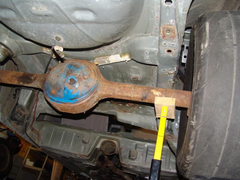

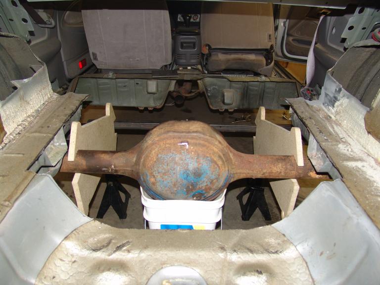

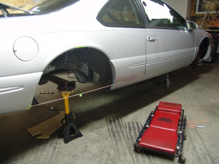

Picked up a set of 315/60/15 MT's and they perfectly. I also went to Fex Kinko's with the chassis blueprint I intend to use and blew it up to full scale. I took the print and traced it to some MDF and cut a link bracket template to aid in me eye fucking the car more. It bought me another week of that.
Looks good so far. The 315s are a big tire and perfect for a street strip car IMO. Now it needs a BBF to balance it out.Originally posted by octanehuffer View Post315 car Gary. If they made a 375, ET street I would have built around those. I can fit a 32x14" slicks in in the factory wheel wells.Don't ask, it's a midlife crises thing.
