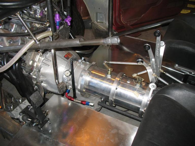

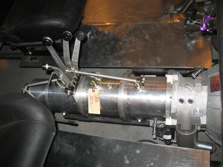

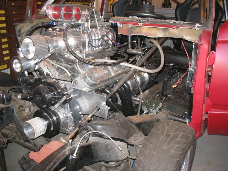

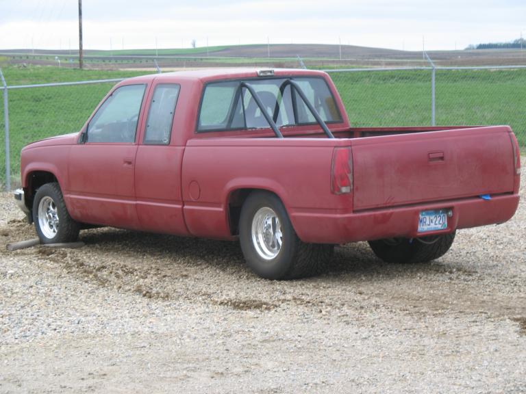

    Well i finally got the engine in and running. Still welding items up yet before paint. Hopefully get it done for the summer. I'm not sure how this will be on the street but sure will turn heads.

    Here's a few more pictures.

      Mother fucker. I want a lenco too!

          That is the coolest ls build I've seen/ heard to date!
            Looks like a Bruno Drive connected to a Jeffco transmission to me....
              yep sure is a Bruno jeffco combo
                  He has more in the tranny and drive then most people here have in their whole build lol
                  Ps I love the sound of a surging blower. Nice Build
                    Nice setup! Looks like a fun build.
                    Yeah, that's a bunch of money sitting behind the engine but it should be a ball of fun to drive!
                    I'm not a fan of blower surge.... it's annoying to me. I realize every combination is different, but typically I consider blower surge to be a sign of a poorly tuned engine.

                      I realize every combination is different, but typically I consider blower surge to be a sign of a poorly tuned engine. [/QUOTE]
                      Damn i wonder what the alcohol dragsters and funny cars would run with a properly tuned engine? haha Just kidding. I think it has to do with the blower set up at as far underdriven or overdriven etc.
                      I'm going to see what i can do about it because when the trucks in drive or reverse and the engine surges it breaks the tires loose. The brakes have a hell of time to hold the tires from spinning everytime the engine surges up. I'm also going to go through the brake system with a fine tooth comb. I'm running two master cylinders one for the front and one for the rear. I'm thinking i have more front brake pressure than the rear so that's why the tires spin at a dead stop. Both the front and rear masters are 7/8" with stock gm front brakes and strange 4 piston discs on the rear. 1/4" line ran to the front and rear to a -3 braided then to the wheels. Any guesses before i tackle this and get a pressure guage inline to see what's going on?
