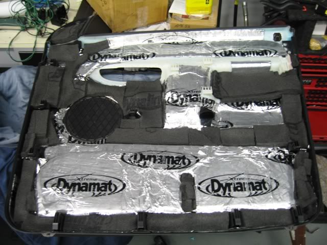

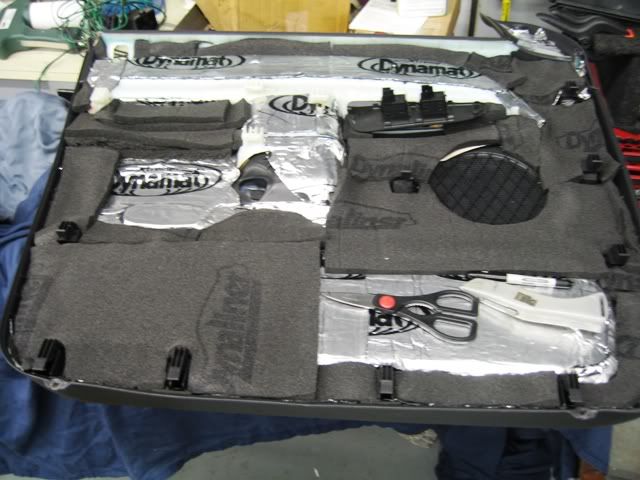

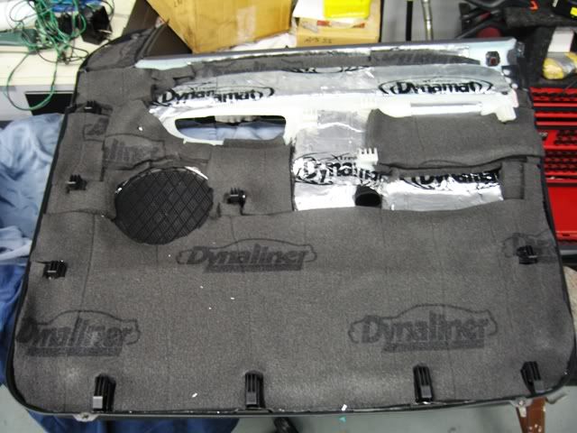

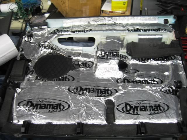

            Here is todays progress. I used about 9 sq feet of xtreme on each front door panel and about 11 sq feet of 1/2 dynaliner onthe panels. I built up any voids, some spots 2+ inches thick of dynaliner to create a pretty solid panel. I would say each panel is now 2.5 times the original weight and bass response from the stock fronts have improved greatly. All 4 door panels are done, I still however have to finish dynamatting the front doors them selves.

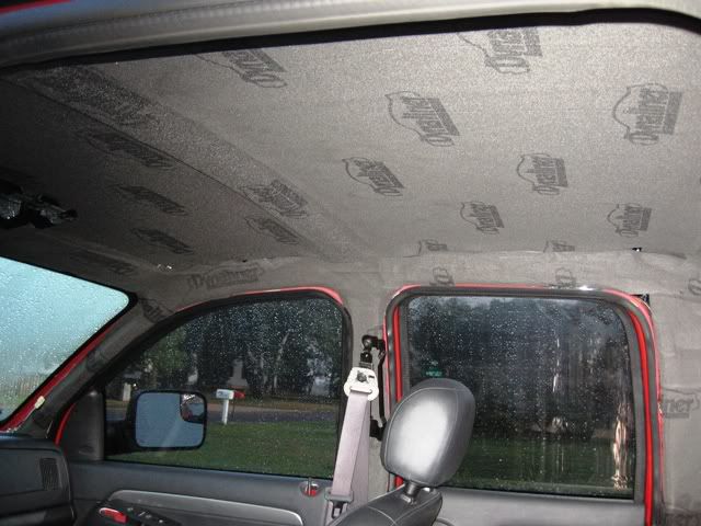

            I also finished dynaliner on the roof and pillars. 1/2" on the roof and 1/8" on the pillars. I hope to get the headliner installed this weekend.

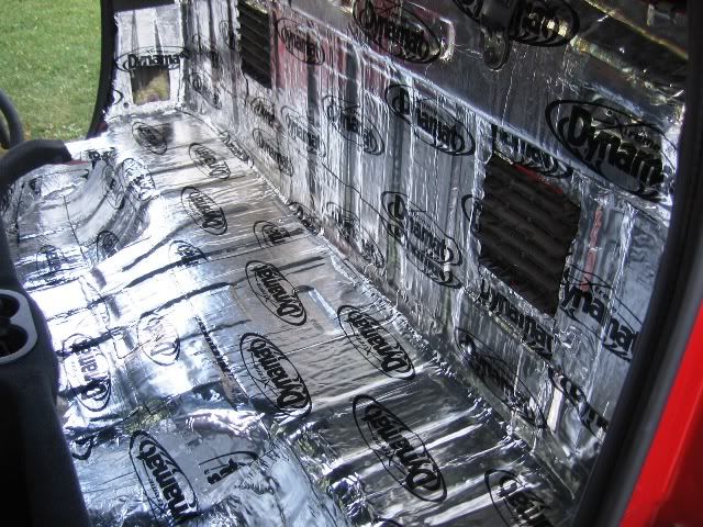

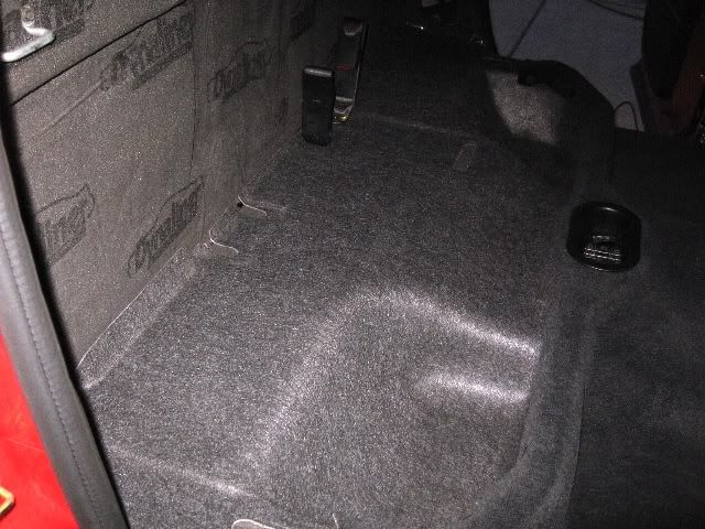

                        2nd layer of xtreme on the floor and back wall
                        12sq feet of 1/4" Dynaliner on the floor and 12sq ft of 1/8" on the back wall.

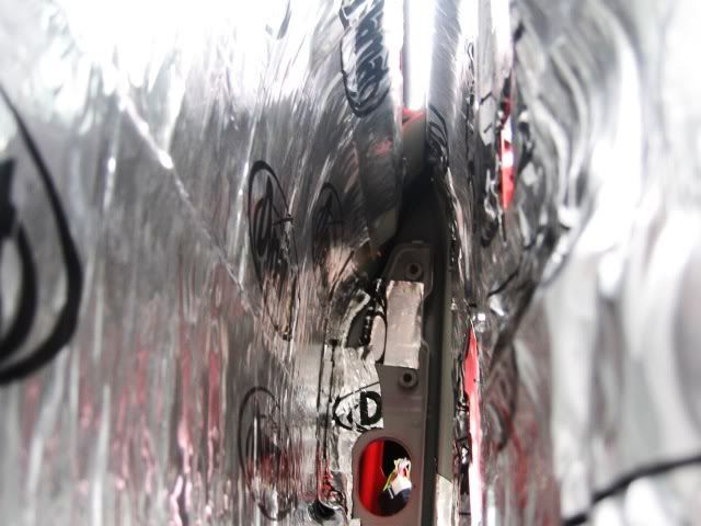

                        Now I just need to figure out how I am going to block the sound coming through the rear vents, yet allow pressure to escape the cab, I think the stock setup can be approved upon.
                          [imf]http://i150.photobucket.com/albums/s99/ACRucrazy/2004%20Ram/audio86.jpg[/img]
                          [imgf]http://i150.photobucket.com/albums/s99/ACRucrazy/2004%20Ram/audio87.jpg[/img]
                          [imfg]http://i150.photobucket.com/albums/s99/ACRucrazy/2004%20Ram/audio88.jpg[/img]

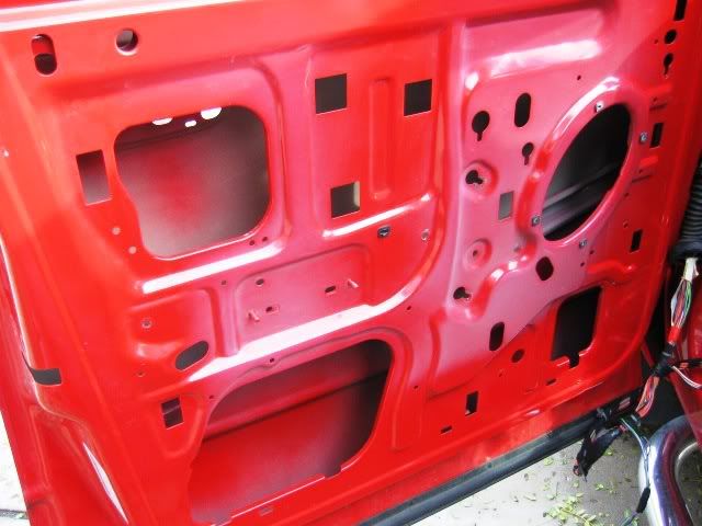

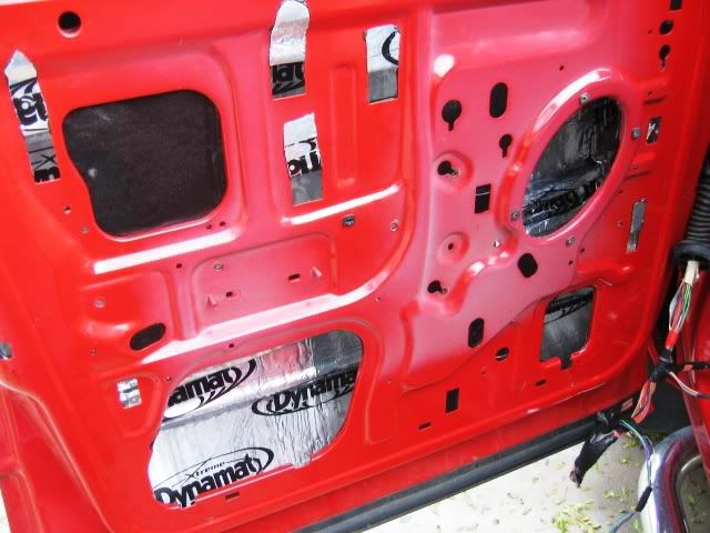

                                I spent 6 hrs working on the truck trying to finish up some of the bigger dynamat projects.
                                Started on the drivers door itself, same treatment as the passenger. Used 18 sq feet on the door. Both front doors I am waiting to Dynamat the out side until I figure out what I am going to do for new door speakers.

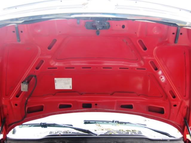

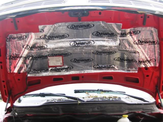

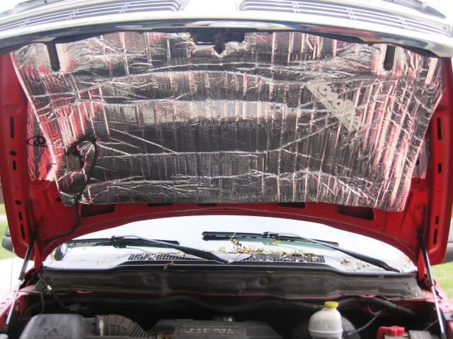

                                I also decided to get the hood done with. I never did a hood on any of my vehicles, wasnt sure if it was really worth it, but figured if I am going to go all out with the inside, there isnt a better vehicle to try it on than this one. I used about 8 sq feet of Xtreme and 1 full hoodliner kit which is 3/4" thick with thermal backing. I was suprised how well the hoodliner sticks. Be sure where you want it when you stick it!
