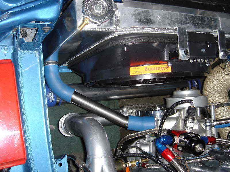

    Well i finally figured out my upper radiator outlet problem.
    Cut off the top straight outlet and welded a 90 degree bend there to point it away from the turbo.

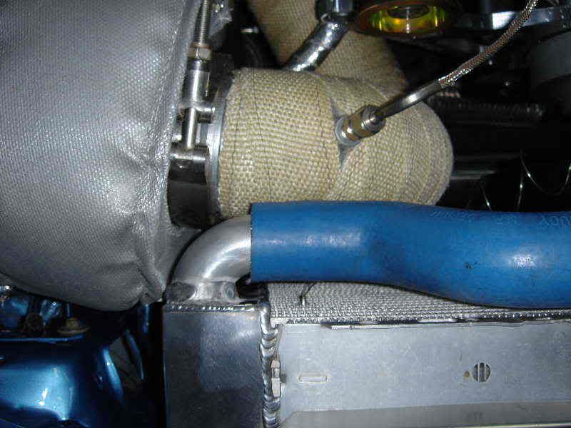

    Another shot.

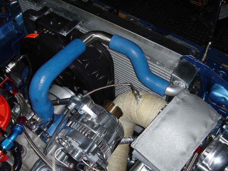

    Also got my bottom hose made up.

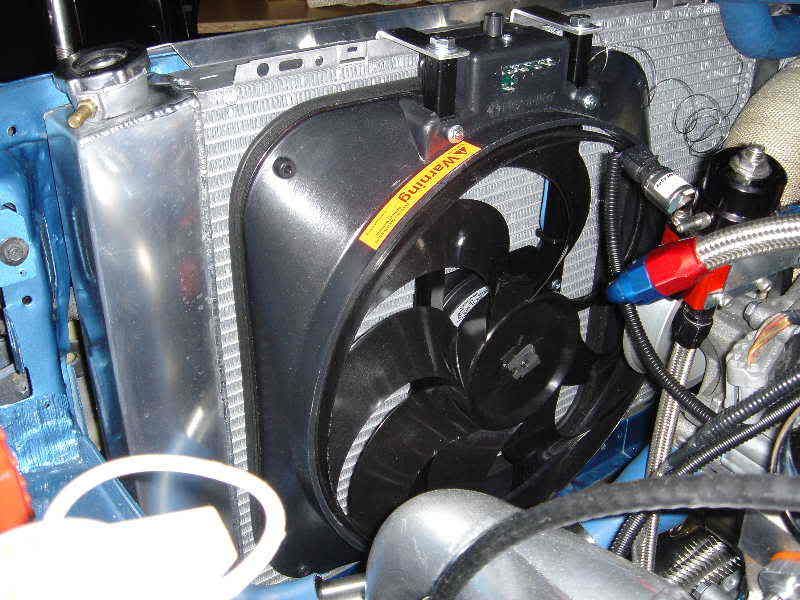

    Then the new 3300 CFM Electric fan installed.
