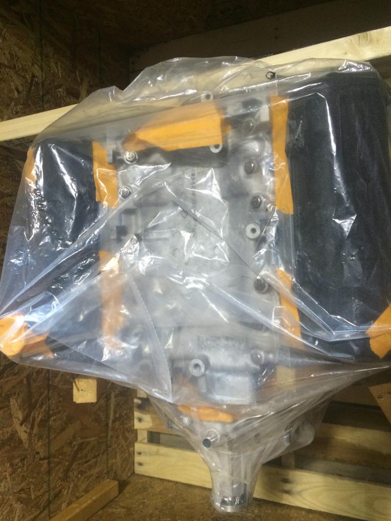

    Now to remember where this goes............
    Time for some wrenching. With the rain in the forecast until Saturday things should get done. Click image for larger version
    Honor, Grace, and Diginity
  • BirdofPrey97
    • 1550
    Cam specs with the 1.73 Rockers 224 in 228 ex lift is .602/.610 112 lobe sep
    The pistons are Diamond custom 9.5:1 pistons. Ceramic coated. Bored 20 over. The rods are eagle H beams. With upgraded ARP 2000 bolts. Morana main girdle with ARP studs. Oil pickup and fitted oil pan Morana
    Steigmeir stage 3(sp) Heads Flow was 210 and 178. Cerdi 48 fat valve job stainless Ferrea 1.84 and 1.57 valves
    BHJ Balancer
    Ran a 10.07 previously. Hoping to be in that range again.
