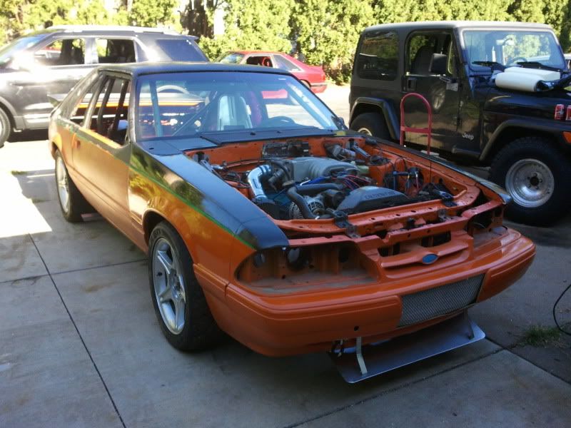

    The Build begins....the car is already a Frankenstein...

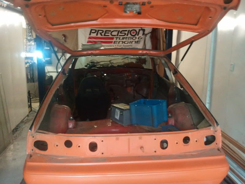

    The old drag cage, which didnt meet the requirements for LeMons, so it had to be removed.

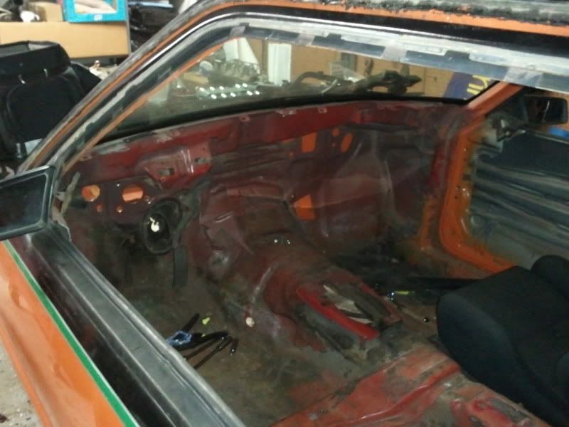

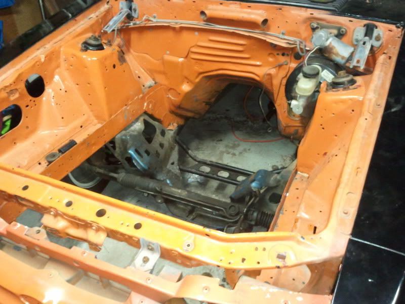

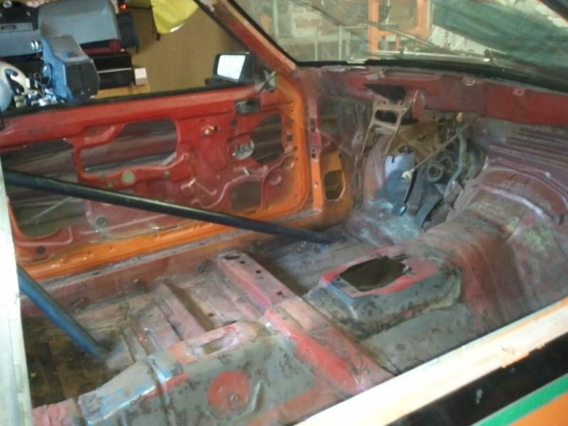

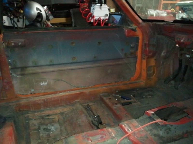

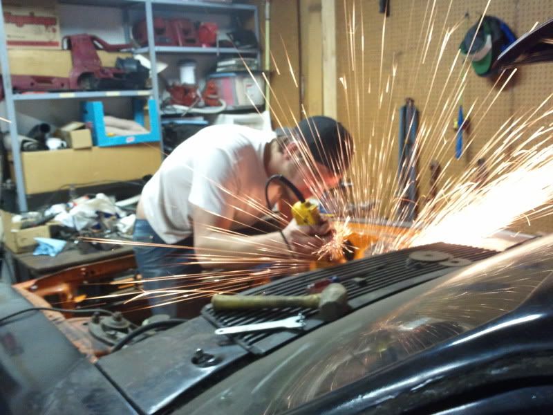

    The car was pretty striped already, but day 1 was spent stripping it down even more.
    Derrick doing exactly what Derrick does best, remove unneeded weight. Thanks to derricks persistence, the car weights 2640lb's without a driver.
    Old cage cut out
    Door skins and crash bars removed. You might be surprised how heavy those crash bars are!

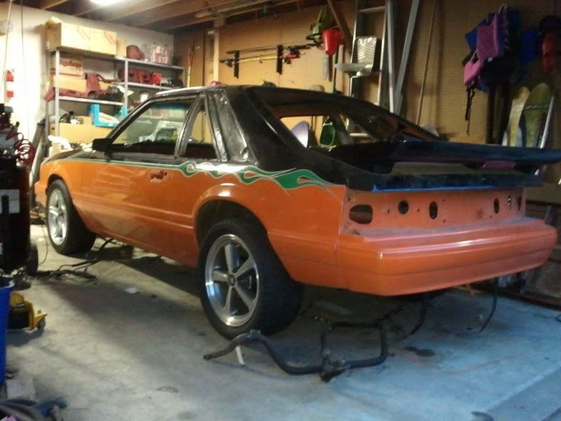

    First time the car was put on the ground in a long time

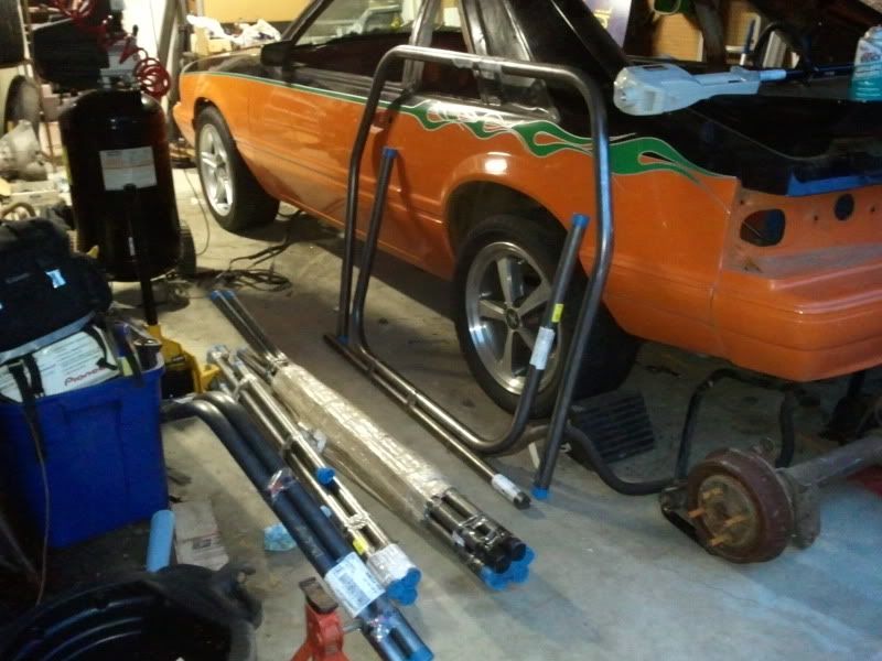

    Pre-fabbed cage from S+W Racecar.
    This was the first time this car was out of the garage in a loooong time. The car has a cowl hood quick arent allowed, so we had to find one of those as well.

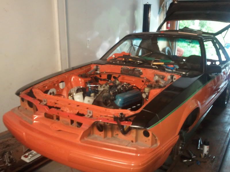

    The motor, nothing special, stock 302 that was sitting around.

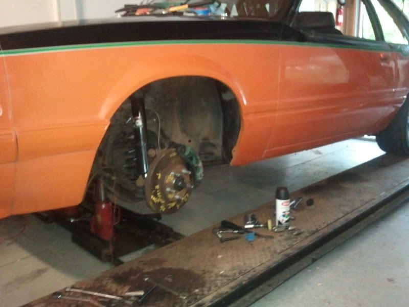

    We upgraded the brakes, PBR front brakes off a GT. Hawk pads. SN95 master/booster. Custom brake ducts. Really nothing special, but still alot better then fox brakes.

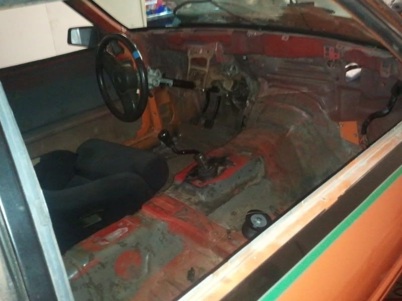

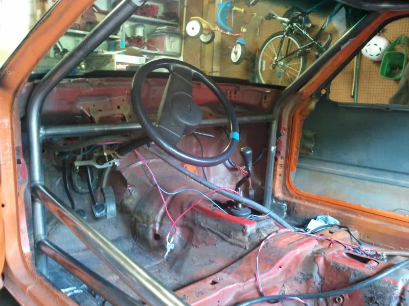

    Running a stock T-5 (with a spare just incase). We got a freebie seat from our "consultant" Steve...although we later found out that seat would not meet all the LeMons requirements so we had to go aonther route.

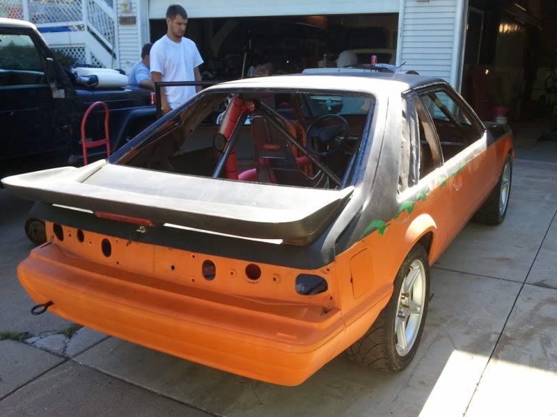

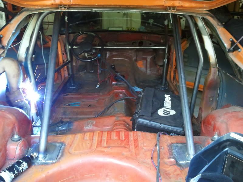

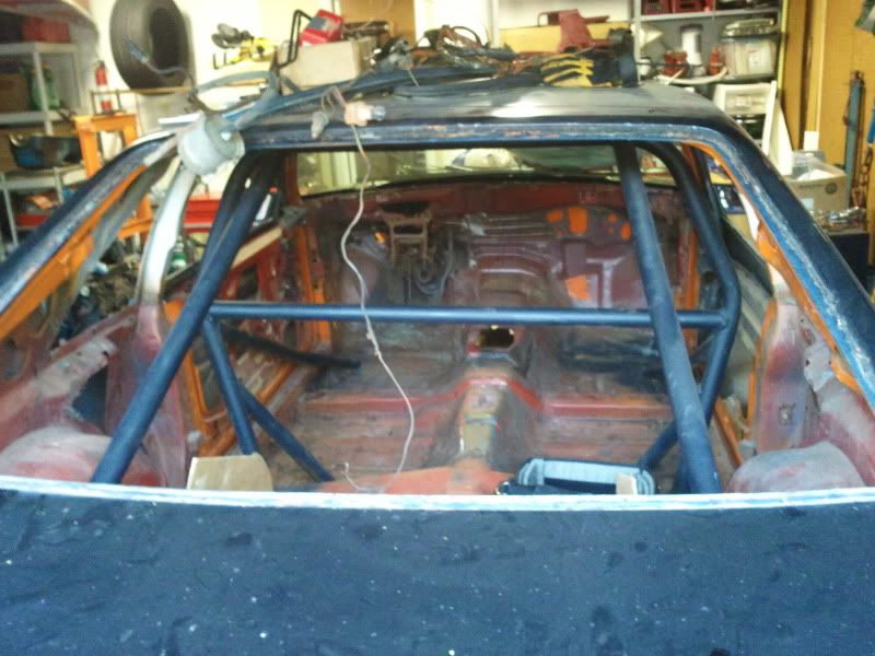

    engnerdan (Dan) from D+W Metalworks welded the cage together, did a great job!

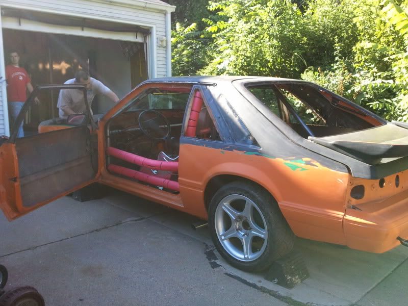

    The cage was only 95% completed that day since we needed to mount the seat before we could complete it, and we left the passenger door bar off for now to make it easier to get in and out of the car for the build.

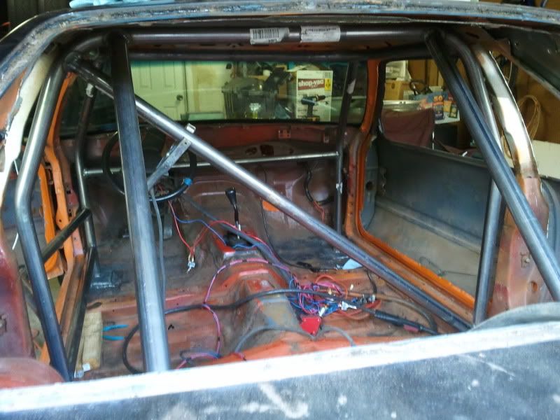

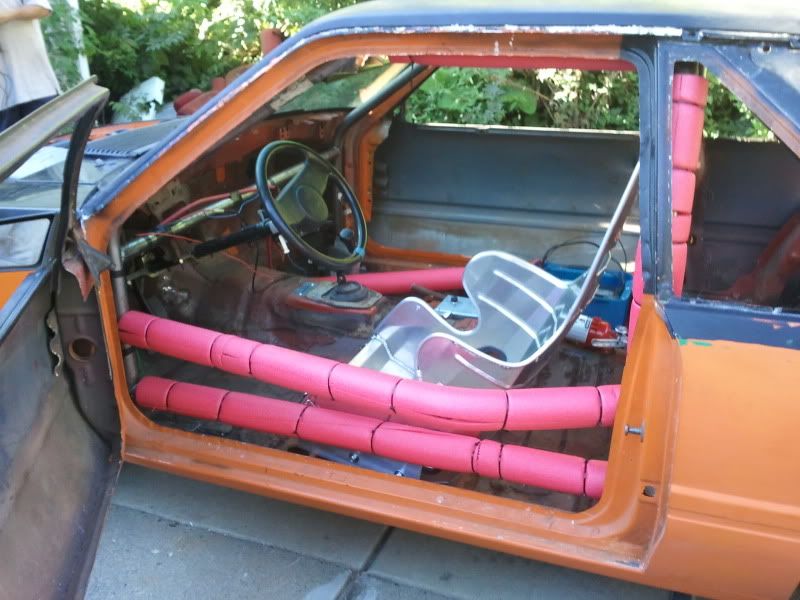

    The cage, main hoop with diagonal, halo, front bars, rear stays, door bars, dash bar.

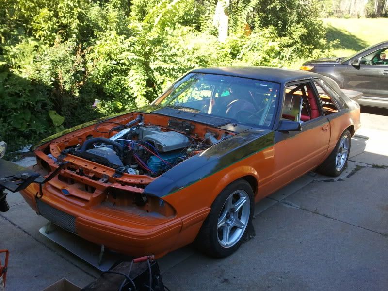

    The car out of the garage, almost complete.

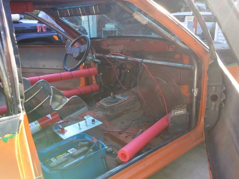

    The new seat, a kirkey (without the cover)
    Control panel, battery mounted to new location
    Drivers view

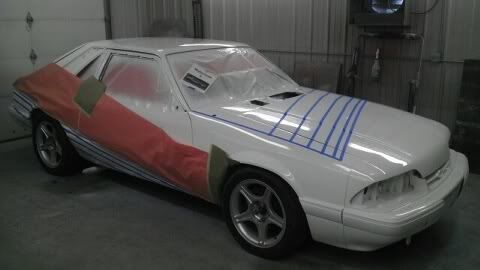

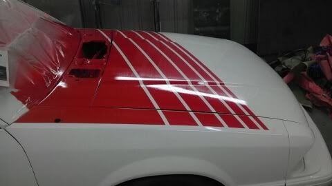

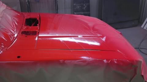

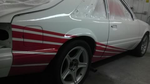

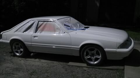

    paint time, all prep and paint done by Wes and his dad

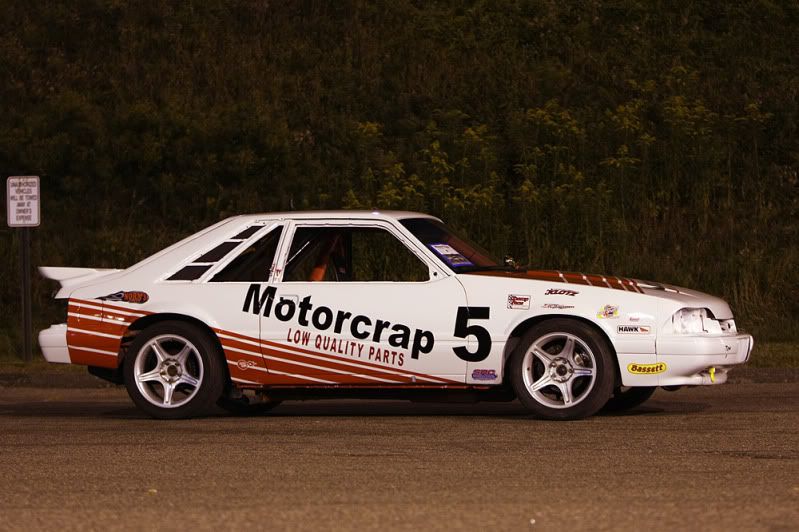

    Finished project. The car is based of the 1985 IMSA GTO Mustang. being LeMons, we dubbed it Motorcrap.
