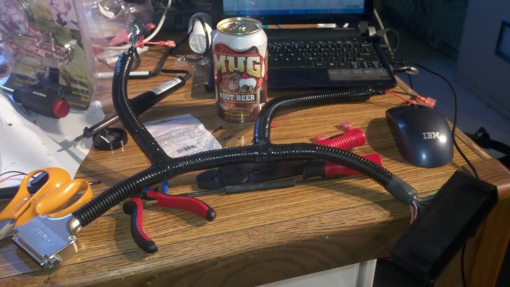

    I forgot to throw up my modified adapter. One leg was added for the LC-1 gauge and the other was for the LC-1 controller itself.
    I made a short idle and rev video last night.
