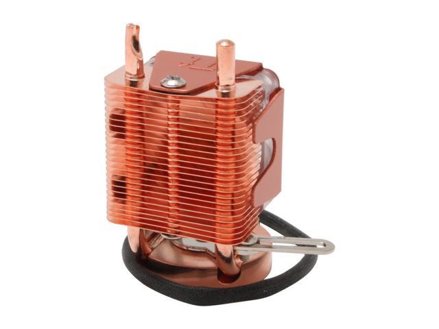

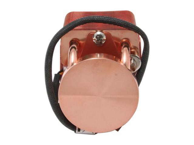

                          I was at the egg looking at fans this morning and came across this.
                          Wish I could get it to fit in my case lol.... don't want a full tower case, trying to keep it mid size.
